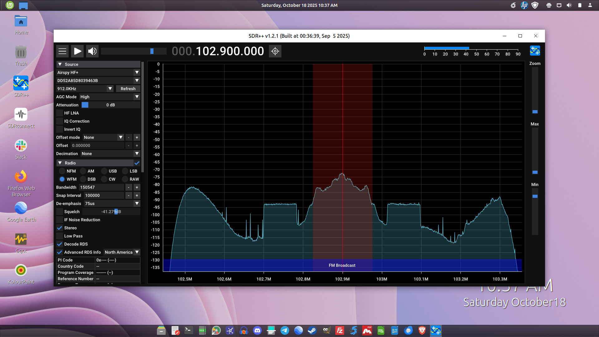

Airspy does not make a linux version of SDR# software but there’s a nice piece of software out there called SDR++, which will also work.

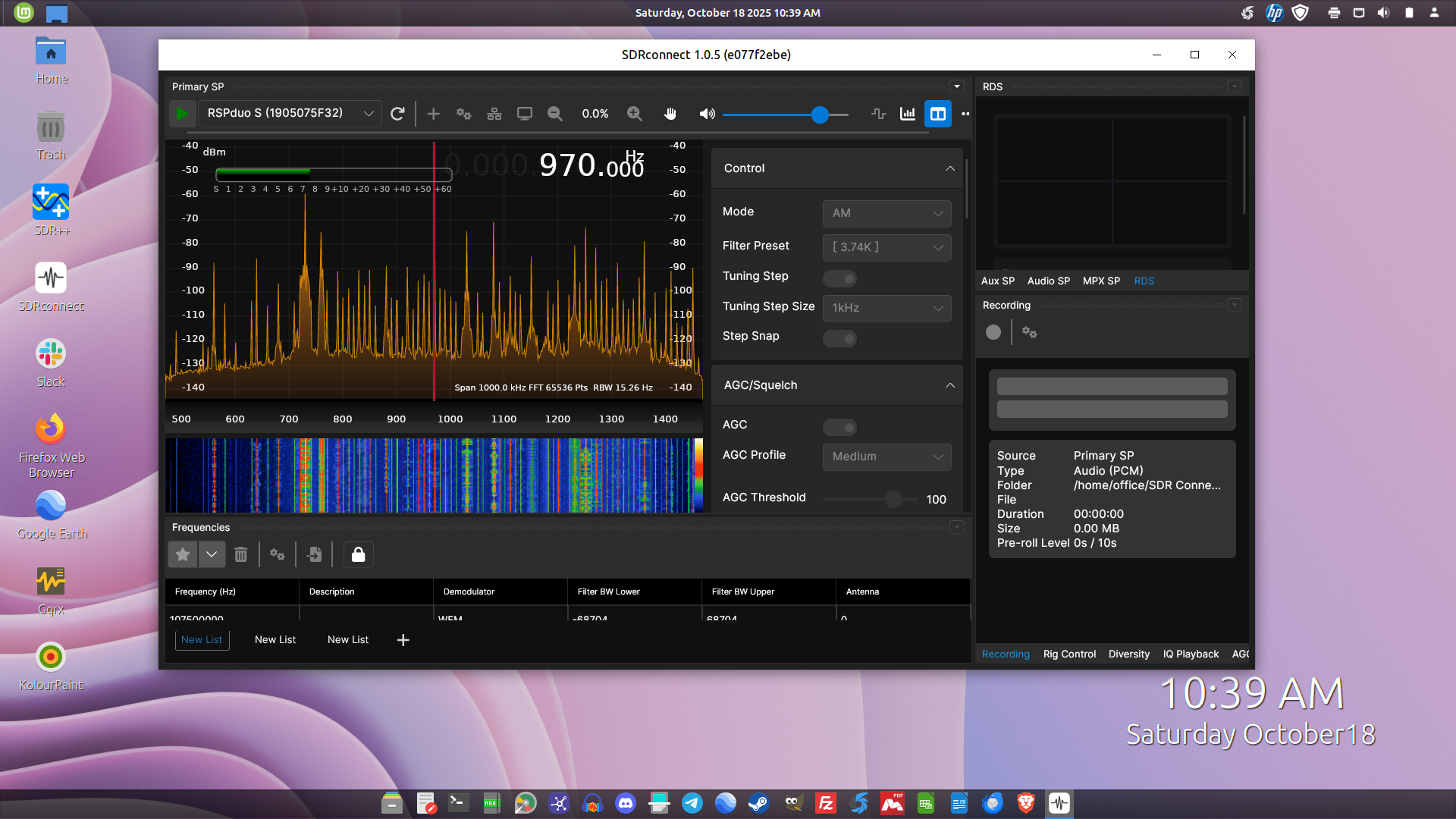

SDRs made by SDRPlay have their own software that supports linux called SDRConnect. SDRConnect is a full featured software with fast decoding RDS and Diversity mode, which is a mode used for phasing two antennas to create a null. SDR++ will also support SDRPlay products.

Those of you running dongles will find that the RTL-SDRs are supported by SDR++ on linux.

SDRPlay’s RSPDuo and SDRConnect under linux.
Airspy HF+Discovery and SDR++ under linux.

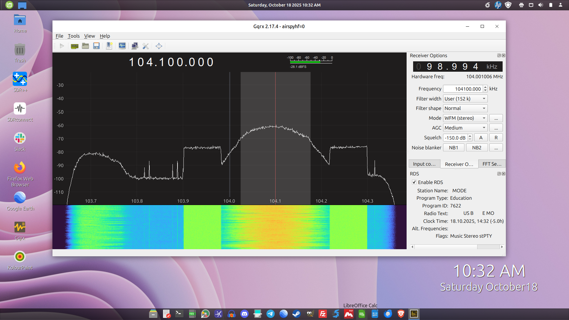

GQRX and Airspy HF+Discovery under linux.
